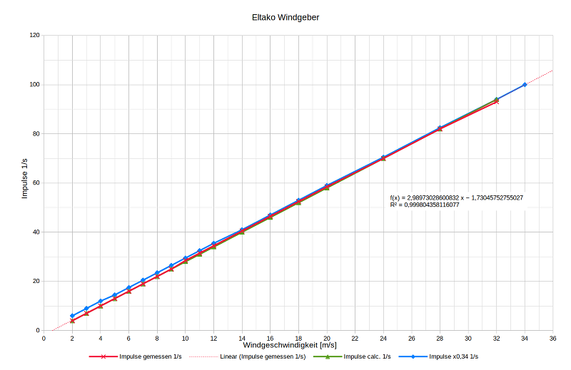

yes - there will be a difference especially at low wind speeds.
This is typical for this kind of anemometer. They have a certain breakaway torque and therefore a minimum windspeed to start spinning.
Also with low wind speeds the friction will contribute most and will vary from sensor to sensor (and time).
So at low wind speeds you will experience the biggest uncertainty anyway.
But the big advantage of this kind of sensor is the great range where it is almost linear !
A wind generator generally will behave similar - below 3 m/s most of them won't deliver power...
I've prepared a diagram on that:
If you really want to be more precise at low wind speeds and therefore adapt the algorithm in the Python script - then use the linear regression formula : Windspeed [m/s] = (Impulse per second + 1.73) / 2.99
This bit of floating number calculation not really does a difference in effort ;)

Thanks again for visualization.
My problem is, that i need more or less precise to know, if the windspeed is more then 4 m/s average in the year. Otherwise it will not work effectively.
The windwheels, I am interessed in, have 2m in diameter in a height of 10-15m, really small wheels, compared to the "real" ones :)
And they start turning und produce energy at 2 m/s.
So i really need more precise in low values.
My max-values in the last days with the factor 0.34 were under 8 m/s.
My idea is, not to change the code, but setting the factor to 1, to just get the average impuls-counts per second, and then do the exact calculation after in excel or programming, that should work, right ??

Hi Paul,
yes - good approach ! Correcting the measurement data later in postprocessing should work.
But this will work even with the linear factor of 0,34. So you will not loose the convenience of observing live speed data.
The log data will be precise enough to reconstruct the raw data also with a fractional factor.
